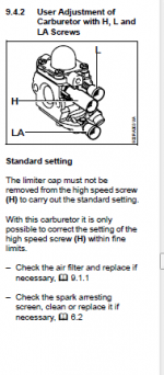

Put the screws back to OEM config. Shouldn't have messed with them.

Here are a couple snips from the manual.
