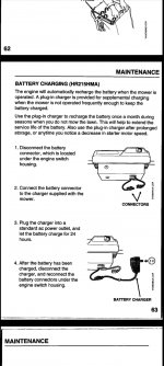

Just found the owners manual, it does say the engine will chage the battery while running, that's why I looked for a stator in the parts diagram.

using Jacks for a parts diagram (there was no serial number posted by the OP so no idea if it is the correct one) the flywheel is 31100ZE6802 and the coil and charge assembly is no longer available but it was 31630ZG9003 31630-ZG9-003 .
