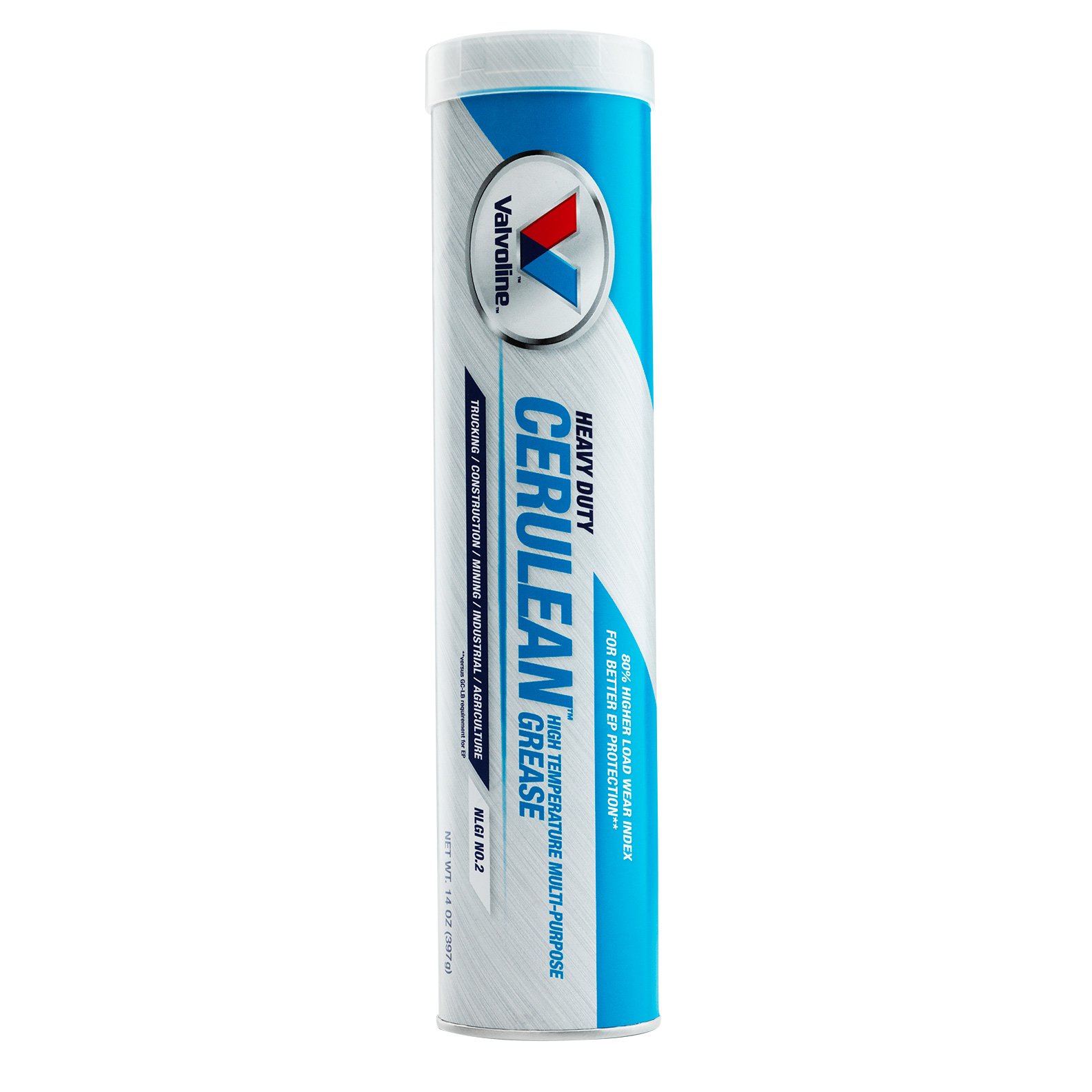

Do you know what the red grease is for? It is a "sticky" version of grease. Red = sticky. As in it doesn't flow. As in it doesn't move. As in once wiped away, there is no lubrication. Worst grease on the market.
What you need is the light brown/cream colored old school #2 NGLI bearing grease. Or the black moly flavor. Blue is water resistant for boats.

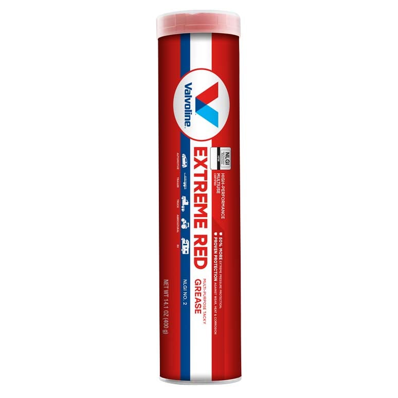

Red and tacky is a #2 NGLI grease. And is recommended for high speed and wheel bearings.

I have been given mixed signals on the right grease to use. I guess I need to order the stuff that Scag recommends in the manual.

I have the Valvoline Extreme Red in a new dedicated gun just for the spindles. This is the third set of bearings in less than 500 hours service. I am gonna hand pack all the new bearings first and time will tell. None of my bearings have ever failed to the point of seizing up but they had excessive play and noise.

Hi BrentW,
I think that would be a wise move. When you open the new spindle assemblies up, you might be surprised.
Pre-assembled spindles typically come with a minimal amount of grease in the bearings, and I highly doubt they are truly packed with any concern toward longevity.

Red and tacky is all I use and buy it by the case. If it were so bad (slomo) how do they sell so much of it? Ha ha 2x
