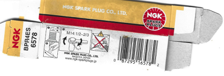

With sealing ring per NGK. Taper seat has a different spec.
Now of course this for new plugs, older used plugs it is as Bert suggests as the sealing washer is already crushed.

27Nm is high for a plug with a crush washer. That is more like a taper seat plug in an iron head. I am with bert. 1/4 turn after finger tight.

Maye this will clear this up...As 27 nM is not that bad depending the plug thread size.

Seat by hand and 1/4 turn for new, 1/8 turn for used.
