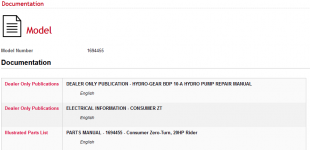

First not all of us know what is posted in other threads. I for one don't keep up with every thread as I simply don't the time and people like is the reason I am just about quit posting anything here.
The 1694455 did not comes with a 20hp Kohler but instead came with a 20hp Briggs 358777-0280-E1 which a v-twin which has a similar looking air filter box as a Kohler Command v-twin.
Now if it does have a Kohler CV20 or similar it is a transplanted engine and I do hate it when the label goes missing. This is why I records every customer equipment numbers as I have seen labels to go awol between time they are in the shop.
As for the shutdown both PTO and fuel solenoid operates off the same ignition switch circuit and be as simple as a bad wire terminal loosing contact since they use F56 terminals.
In this case the wiring schematics for the 1694455 are dealer only accessible. I could post them but the flame throwing here has cause me not to be willing to do that.
