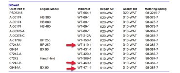

you can also contact these folks. They seem to have all the carb kits others don't stock. I have bought their kits lately and they are very high quality. Your engine parts manual does not list the actual carb but sleuthing on the pages makes me think it could be a WT419 or WT469, or WT 471 all which appear to take the D10 WAT gasket kit or K10-WAT repair kit and Metering spring is also listed. BUT - I would call these folks and see what they think.

Thank you all for your replies...they helped a lot. I finally got some time to remove the carb and it is a Walbro Wt-471. I looked around for a replacement and only found a few places that sold them ($40 and $60). I was hoping to find a cheap Chinese knockoff but no luck. After watching a video about rebuilding a similar carb I don't think my chance of success would be all that great plus it would take quite a bit of time. I've rebuilt carbs on 8 cyl car engines but the parts in the Walbro seem microscopic and very susceptible to being bent/ misaligned.
I did come across one web site that said the 471 was superseded by WT-633. I found one picture of it and it did not have the primer bulb and didn't seem to have the 2 position speed lever. Anyone know for sure if the wt-633 is a real replacement? or where I can get a 471 cheap?
