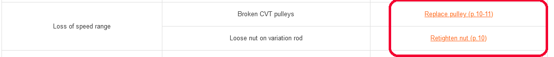

Also this is one of the service bulletins related to the problem.
bones774
Jun 29, 2022
9
Plenty of movement in brake pedal. I think thats covered in the video when they tell you to step on brake to unlock the drive release, but i will check it.
Just gave the replace pulley a quick skim, they mention special tool to remove flange cover nut?? Can I work around that?
