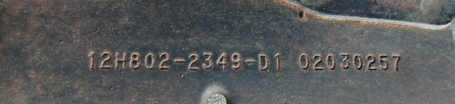

Can you post a photo of the model/type/date code?
