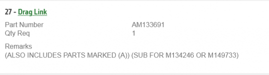

For tie rod ball joints since they are probably metric female threaded - JD This one you need to check which you have as there is also a SAE version. And boy are they proud of these.
- M12 Metric RH Female Threads - AM132814
- 5/8 SAE threads - AM133692

I'll look closer at the ball joints. When I called JD parts...they said that you can't replace just the ball joint ends—on the GT225's—but have to replace the whole tie rod - that comes with the ball joints. That is, if we're talkin' about the things I think we're talkin' about.
