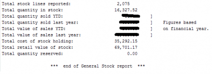

It is the only way I can do it. Just way too involved otherwise. I would up to my eyeballs in paper otherwise. I tried the index card system for inventory but it just didn't for my operation.
There is no way I could keep track of over 16,000 parts even through I only have 2,075 different sku numbers in stock. Using a bin system to help finding them. And just the ones I have in stock of the 850,000 sku numbers with descriptions and pricing that I have loaded on my system.
Of course cost is for items only and don't including shc.
#37
Hammermechanicman
Hammermechanicman
16000 parts. Dang! I have around 400 parts in stock. Mainly oil, air and fuel filters and couple dozen different spark plugs, deck wheels and a bunch of carb stuff. So many different blades now i quit stocking them except a few i know current customers will need. Same for belts.
