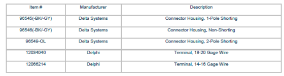

The problem is the Delta Systems is not selling the housings to small companies. I would like to buy them myself especially the 96549-OL ones which are the dual pole shorting one but I have not found a source for them yet. Now you can buy the 96545 connector housings, even then you must buy at least 10 of them.
https://nexelec.com/DELTA-96545/
They are currently out of stock so there is no telling when they be back in stock. But Nexelec has posted a lead time of 3-5 days so that might what they using. Anyway I ordering 20 of them myself as the off season is quickly approaching here and I can over the winter months.
And note you must have an open barrel crimper to install the wire terminals and an appropriate pick to remove the old terminals from the current housing.
