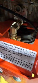

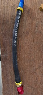

This is what I did on my Honda powered Maverick HD. Fumoto valve, brass 1/2 nipples and 90, and a size specific adapter for the block
