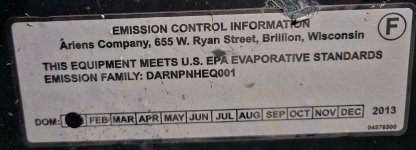

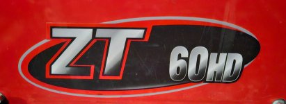

Long time subcriber & reader - Only my second time seeking assistance. My apologies up front for the lengthy post - I've tried to be thorough, tho....
First off:
2013 GRAVELY ZT60 HD (w/ Kawasaki FR730V)
Model: 991084
S/N: 021187
Warranty Code: HB
Hydro Gear Commercial ZT-3100 Drive System
Has 903.7 hours on a working hour meter.
I've owned it a year now. I mow a 4 acre yard about every 4-7 days from March through mid November.
I've done a full engine tune up twice now (oil, oil filter, air filter, fuel filter, plugs; and blades with blades I got with the mower & sharpened).
