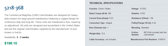

The 5104572FS (supersede from 5104572) appears to be a Warner 5218-368 but even they got a 2-3 week delivery window. But it is under $200 from Warnerptodirect.Com. Now of course shipping may be added the price at time of ordering.
And IL this is use on the IS 2600Z series.

Easy fix for this one.
Go to the Warner web site and search for a similar spec unit with the next size up pulley ( blades will spin a bit quicker ) or slightly smaller ( blades spin slower )
Do not go overboard as a 1/4" is the effective limit
Usually a too big pulley will work with the old belt and a too small will often allow the belt to slip .
Dow here in OZ no one keeps a full size inventory so I regularly have to fit incorrect PTO clutches and some times I do it because the 1/8" different pulley is $ 300 US and the correct size is $ 900 ( or more )
