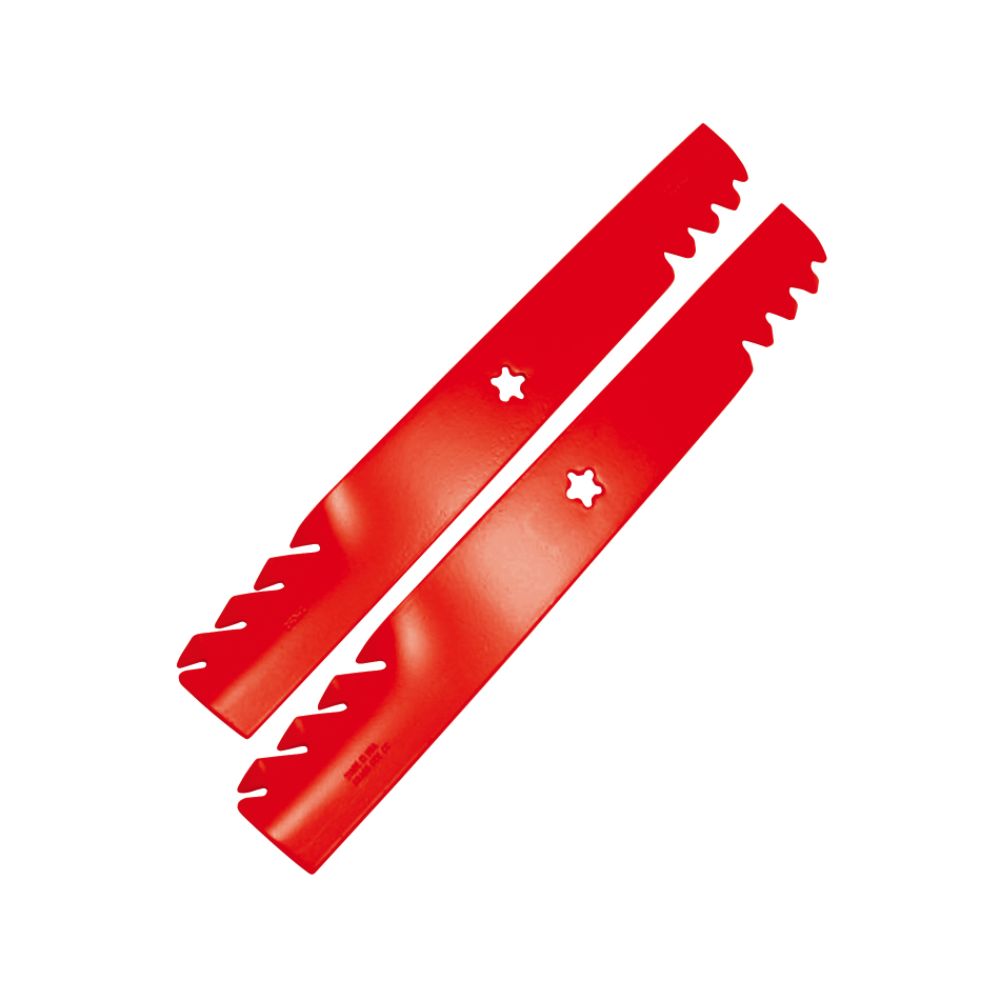

I agree with one person who thought it might be a blade issue. There are several mulching blades. The one already posted was the Gator blade... I have one of those, 2 Ninja blades(one to wear & one a spare)...the black one I am posting, & I have the ordinary blade that came with my mower...it's painted & sitting in storage.
