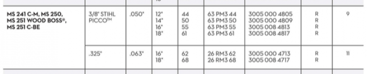

Hi all from sunny Brisbane Australia.
I have a Stihl MS250 Wood Boss that I've had for a few years and I'm puzzled about the bar/chain combinations recommended for this saw by any provider I have checked with on line. It has a 16" bar on it and a .325" pitch Stihl chain with 68 links and .063" gauge but wherever I go to look at bar and chain listings it tells me it should be 62 links and that the 68 is for the 18" bar ... I've measured the bar from the chainsaw body to the tip and it's definitely 16". Stihl's own official PDF data page says this as well so what gives ... I'm mystified?

Ahhh, You found what I found last year about Stihl bars.and other bars. What they claim them to measure and what they do is two different things. They say you measure from the body to tip for bar length but they actually meas measure the tip to the tail of the bar. On the saw I was replacing the bar the co-called 18" bar was under 17". Don't remember which Stilh it was or the actual new length, just remember it to be way shorter what it claimed to be if measure from the body to the tip.
To me it is a con job done on the owner of the saw. Now some this may be the height of the bar being a lot more but I didn't have the time to research it or had an Oregon bar to compare to.
IF you have a .325 bar with 68 DL chain then it is classed as a 18" even if it measures less. Not a problem until you go to cut a 36" log where you actually need the full bar length. What you go by is the info printed on the bar itself and the actual DL count of the chain on the saw.
