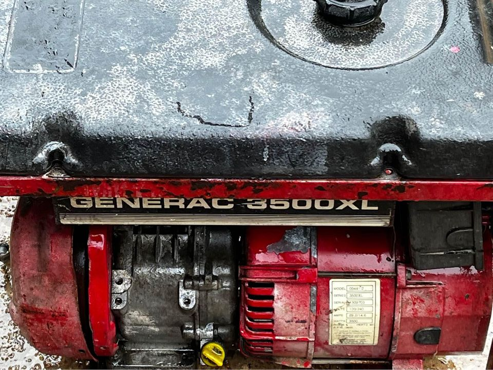

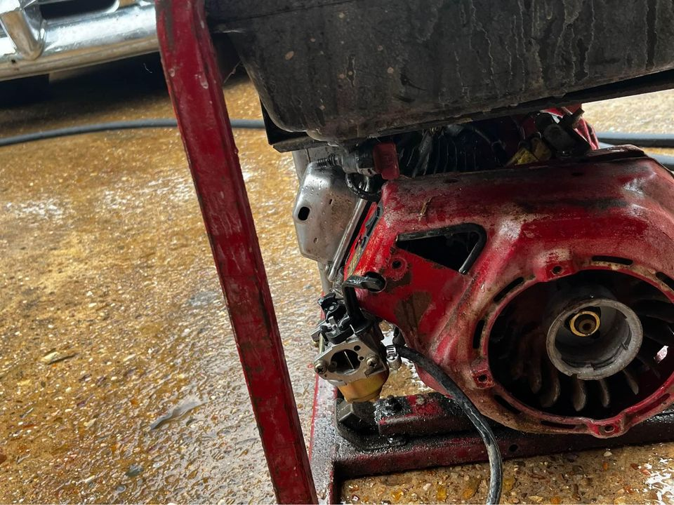

Going to pick this generator up tomorrow evening, $50 .... looks like the guy put a new carb on... from what i've read that may or not be the correct carburetor. He said the recoil starter rope wouldn't retract so he chunked it... Air cleaner is missing as well.
Any common issues with these... Looks like a Briggs engine?

Looks more like the GN-190 engine. Most parts for that model will be NLA and don't be surprised if Briggs or Generac claim it. Briggs will say to contact Generac, Generac will say to contact Briggs. Neither company will support it.

The GN-190 engine is used on the 09441-2 which according to the Generac dealer site says to contract Briggs because they are the support for the product. Briggs doesn't list any of the external components of the engine just the engine short block parts. There have no reference for the carb, carb gaskets, air cleaner, or air cleaner box.
Looks like missing parts are available through Generac if you look them up by the GN-190 engine parts diagram.
