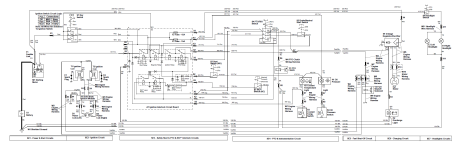

Try dumping(squirting) a little fuel in each cylinder then try starting. It may be a carburetor problem like the fuel solenoid not working.
