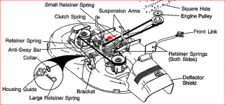

Replaced brake arms, pivot plate, clutch cable on the deck. I'm pretty sure I got the stationary idler pulley on correctly
Put on a new belt as well. Advertised to be 95.5 inches. p/n 144959 is marked on it.
Started engine and the blades turn furiously with the clutch disengaged. Turned engine off.
Clutch lever does actuate the clutch idler properly and there is slack in the belt with it disengaged. Just not enough.
Attempted to adjust the "arc" of the stationary idler and it does change the tension on the pulley but only gets tighter. Red arrow points to the idler.
My only thoughts are I installed in incorrectly, or this new belt is actually too short. Too late in the day to hunt up another or dig into it any more today.
Suggestions?

I would take that belt to a mower shop, or compare it to another belt of the same part number. A mower shop could probably measure the actual length of your 144959 belt to be sure it is 95.5"

Well, as a driveway mechanic, $200 for a belt measuring tool is not happening. I do have an old "tailors tape" that might do in a pinch. The fabric kind.
So, the OD is the measurement to go by? Always wondered about that.
Edit: I found a way to measure the length by making a mark on the side of the belt and rolling the belt along a flat surface and measuring the distance between marks. Still, some sources say the ID, some say the OD. But making a mark on the side of the belt, I guess not that much difference.

I measured both belts I have and they measure just about 94 1/4 inches. One is a cheaper ebay belt made in india the other is by D&D off Amazon several years ago.
Measured by method described earlier. Making a mark on the V side of the belt, matching it to a mark on the floor and rolling it along the floor on the outer flat to the same mark on the belt, the measuring the distance. That should be pretty accurate, right?

Yes it is very close way to measure the OD as long as the belt don't slip during the measuring and both belts appears to be short.
