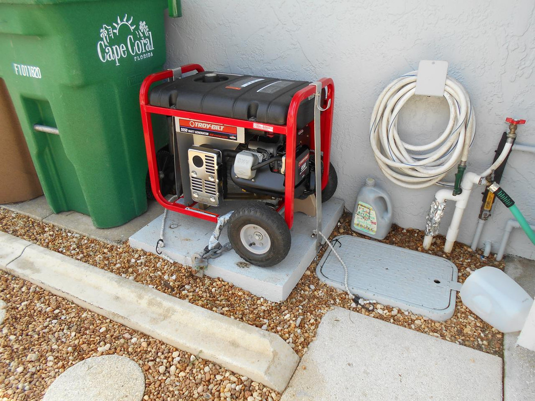

That generator is bolted down to a concrete pad (aluminum straps on each sides and the chain). It's for hurricane season down here and stays outside (under cover) 365. (Bought it used, 0 hours for $300.00 right before Hurricane Irma which got ran 28 hours straight)

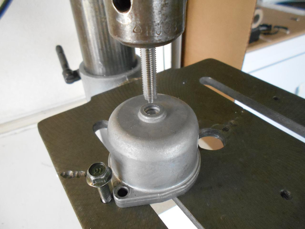

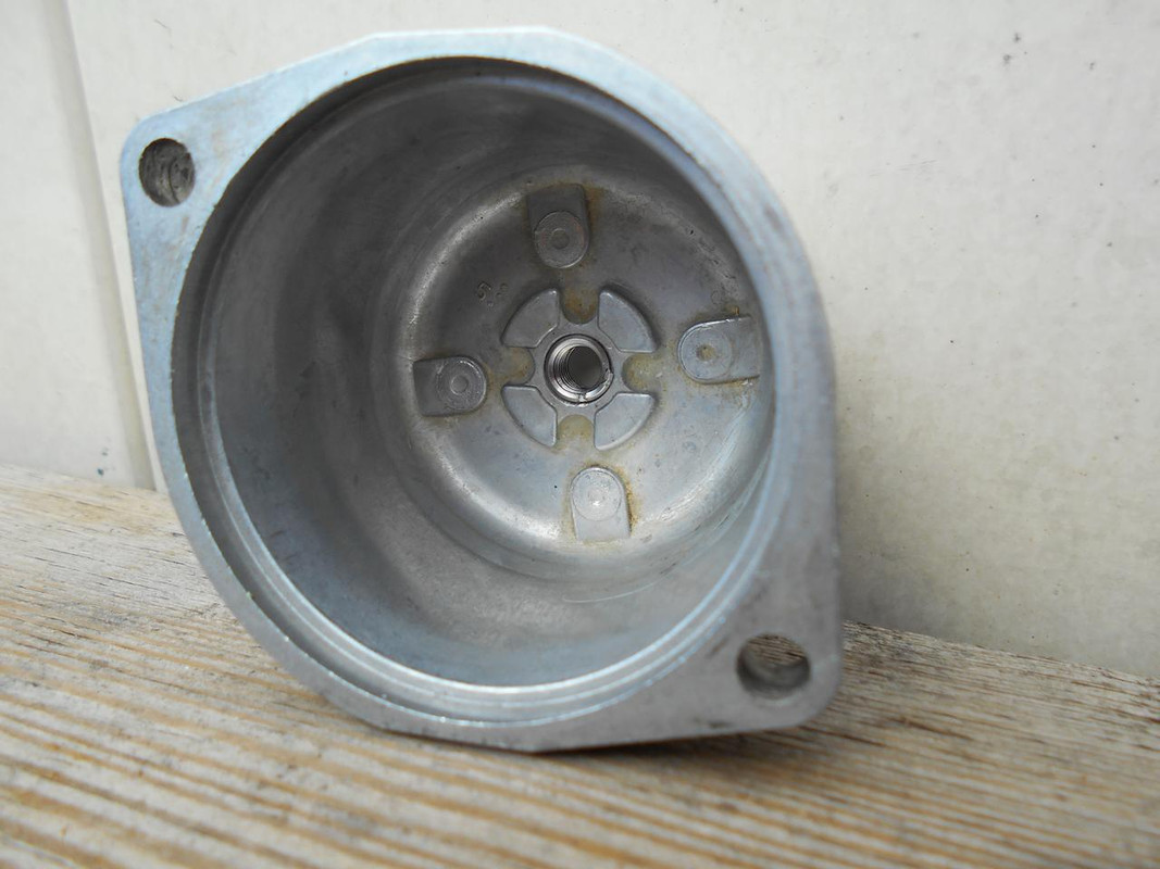

Just an FYI, for every engine of mine (and most customers) with this engine, I modify the float bowl for FULL DRAINAGE with ONE bolt.
I remove the bowl, drill and tap the center for a heli-coil (with RED Loctite). Then install a simple drain plug (see below). You just have to remove the black plastic lower cover to access the bowl to drain... No more clogging...
Some pic's:
Tapping the drilled hole:
The inserted Heli-coil:
Bowl now with a drain plug (where fuel WILL collect and varnish shut the main jet)
