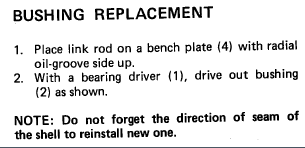

This rod has radial grooves(oiling?). Does it install w/ grooves side riding against the crank web or the other way? The 2nd pic is the way I think it should be but not sure. I think i had previously installed it wrong since the bearing burned up after 5 min of running....sigh
txmowman
Oct 8, 2018
311
You are correct. Towards the outside of the crank web.
