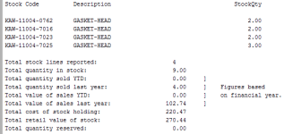

These are the ones that I seen enough blown one that I keep a stock of them on hand. They are not cheap to have on hand either.
