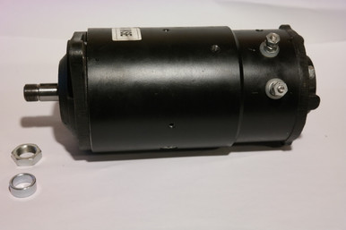

Back in the day...... lots of mowers used starter generators. I don't know if any today. Be nice to know what engine OP actually has.
122
12,909
I have seen one Kohler K301 engine with the old starter/DC generator setup.
But the JD Z445 uses either the Kawasaki or Briggs v-twin engines which uses the newer alternator setup. Kawasaki especially will not charge via the voltage regulator when the battery is not seen present. Bad connections in either the positive or negative paths will cause as well as a bad regulator. The stator only ouput AC voltage so there must be a working rectifier/voltage regulator present.
And the starter on these engines does NOT produce any voltage to charge the battery or run any accessories; it is the stator under the flywheel that does this along the rectifier/voltage regulator.
