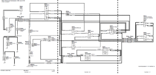

After a 2 week heat spell it was time to mow again, mower was parked in the garage, nothing changed or was done to it as far as I know. However when I went to start it it just "clicked". I thought maybe I had left the key on or it had got turned on by mistake so I put my trickle charger on it, it took a charge and my multimeter showed 13+ after charge. However still no start and still just a click My "instinct" said solenoid so I went ahead and ordered a new one and put it in but its still doing the same thing. The brake switch is new as well so that should be fine and I'm trying it with the emergency brake enabled so the seat switch shouldn't matter but I've tried it sitting there as well. I've engaged and disengaged the blades and cleaned all terminals and ground wires. Still nothing is getting to the starter. Any ideas?

The clicking you hear is most likely the carburetor fuel solenoid.
Starter circuit goes thru ignition switch, PTO switch, Brake switch, Reverse Switch, and finally the starter relay [solenoid]. Otherwords make sure the PTO is off, unit not in reverse, and brake pedal fully depressed.
