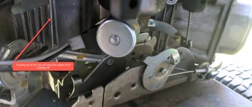

Sorry for the delayed reply, I didn't get a chance to try any of this out until today. I think I've got a carb issue, I can manipulate some of the moving parts to keep the engine on. I've attached a picture that explains. There is a moving rod on the underside of the carb that currently is up when the engine off, when I turn the engine on this moves up and down. I'm guessing this is something that controls the intake of fuel. When I hear the engine about to crap out and push it up, I can keep it from turning off. Can someone advise me at this point what I can do to remedy this problem? I'm guessing cleaning the carb is probably in order.
