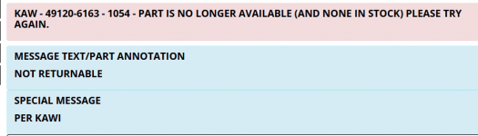

49120-6163 is for the AS04. The following is the two crankcase with 6137 being the most common of the two used. Both number are superseding to the 49120-6163. My distributor is flagging it as NLA per Kawasaki.
AR = As Required
