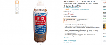

I've had good luck with B12 chemtool with minor rough running and surging.
