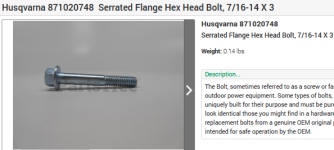

Pretty simple I bought a used Husqverna ...CHEAP, started going through it gonna give to son-in-law, found out it is a MIX of years and parts from everything under the sun and most all wore out, no problemso Im replacing bushings and run into the from axle 2 bushings no big deal, pulled the bolt that holds it expecting a lot of wear and there is none. the bolt is a cap head 7/16 but the shaft on it is smaller in diameter that the thread, thats whats causing the back and forth on the axle- has to be the wrong bolt- anyone??? Should these have a thicker shoulder on the bolt that the thread?

First you don't measure hex screws by the wrench size; unless, you using the open end to get a quick estimate of the shaft size. Hopeful you are referring to the screw size as even a 3/8" normally has a 9/16" head and the 7/16" has a 5/8" head.
Second the YTH1842 came with two different hex screws depending on the variant. One was a 3/8" and one was a 7/16". Actually the early version 3/8 was a carriage bolt which may been replaced with the hex screw by a previous tech.
Bolt Rdhd Sqnk 3/8-16 X 2-1/4
