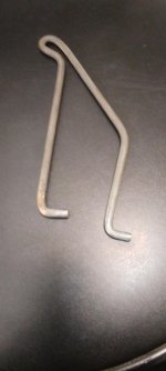

First let me say this, I always Pray for the Lords help with all my mechanic work.
Well I did it and without pulling the deck. I went into my shed looking for something I could make a spring pulling hook out of and I had one of these little hanger rack with about 6 hangers on it. So I borrowed one
of the 1/8" Diameter hangers off the rack pictured below. I had to lay on the ground, get my face up in the deck and study it a few minuets. Hooked my spring on the Idler pulley plate hole and came in from the back of deck with the hook and pulled into place. Thanks for the directions and encouragement!!:)(y)
