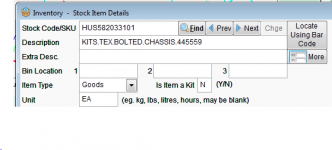

It is still the same Tex frame from what I can see with a replaceable slope draw bar. Old ones were welded on which was a pain to remove when replacement was needed. This means we will still transaxle mounts breakage and the repair kits are still need to stocked. Same frame PN for the XLSi. This also means the frame is only slightly thicker than the 12 ga deck.
