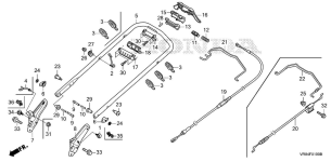

My bad use of terminology, but I don't know what you're referring to by engine brake. It has one bar (blade control lever) which engages the blade, and one plastic lever (Smart Drive Control) which when depressed controls the forward speed.

  • / Honda mower HRN216VKAA pull cord will not pull unless blades are engaged.
Referencing IPL from https://peparts.honda.com/powerequipment/lawn-mowers/hrn/HRN216/HRN216-VKAA/VR84E1900/references
The engine brake can be called blade control.
But as said there is no blade clutch. The blade is directly attached to the crankshaft.
You mower uses items 20 and 22 for the blade control (engine brake) setup.
The blade control lever is attached item 10 which the flywheel brake (engine brake) via item 20 above. Which must also be disengage for the engine to even fire up as item 9 is the kill switch.

You know, I think I was having a senior moment and the mower is working as designed. My 30 year old mower, which recently died and was replaced, had the ability to be started without the blades engaged. It had two levers, one engaged the blades and the other the drive wheels. When both levers were released, the mower would continue to run with without any contact with the operator, whereas my current mower automatically shuts down when the blade/brake lever is released.
Thank you for your comments.
