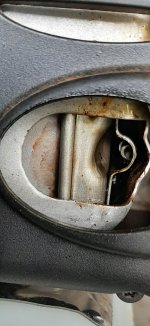

another thing - it doesn't really smoke much or hardly any when idling. Smoke becomes apparent when I rev it. This was not the case last year or before. There is also some oil-like residue around the muffler. See attached pic.

  • / Help- lawn mower making knocking sound and trimmer smoking white
If it clears up, just a couple of puffs, I wouldn’t worry about it. Left over fuel will collect water, even with stabilizer and an empty tank will contain moisture over the winter.
