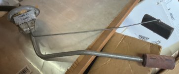

I am helping a friend dispose of her deceased father's garden and farming equipment. She is going through his stuff and trying to decide on what to keep, what to throw out and what can be useful to someone else to sell. Can anyone help ID this part and whether it comes from a lawn tractor, farm tractor, or ???? Jack was a Ford guy and all of his farm tractors were vintage Fords from the 50's and 60's if that is any help. Thank you in advance for any help with this.

That is a in Tank fuel sender for a F series Ford truck.
You can re-search on-line using the numbers on the sender to get exact.
New now days they are about $60 and up for new.
If it's new and you know the exact fittament it would most likely sell on FB for 1/2 of the new price if it's new. If it's used it's just trash.
The filter sock makes a good strainer when placed in the bottom of a funnel, etc.
How do I know this. I've replaced them.
