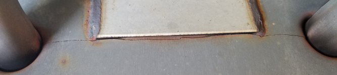

The only defect I did find was a crack in the muffler.
Okay, there it is. Any suggestions of what I should look into next?
