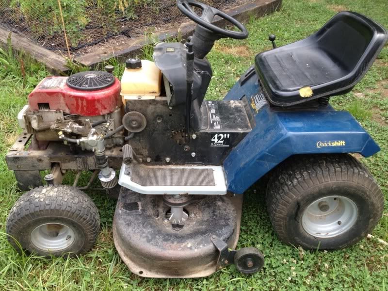

Got maybe $100 invested in her so far.
#1
J
JoeNoble
One more mow then I'm gonna tear her down for a good cleaning, some minor repairs, carb rebuild and new paint.

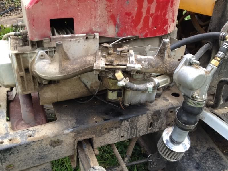

What does it have for a carburetor, fuel pump,and air cleaner it looks different to me?
#3
J
JoeNoble
I had some issues with it getting too hot and shutting itself down last year and I figured that might be due to the fact that the air filter is mounter almost right on top of the muffler. So I took the extra intake mani I had and mounted it on the other end of the carb and mounted a cheap water outlet from a car to the other end of the extra mani and mounted a washable reusable filter on that (it's actually a really big Spectre breather filter). The fuel filter is a mr. gasket meant for a carb'd car and it has the replacement element inside.

Perfect air filter location for plugging up fast me thinks:wink:
