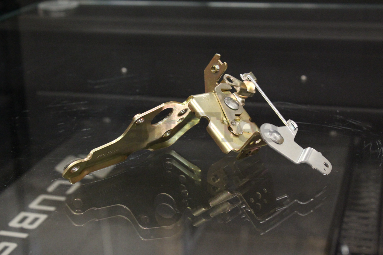

Looks like the 122K02-0337-E1 engine. Is the governor spring present and connected
Item 209a is this diagram
Hooks between the loop in item 202 and the eye in this item
You were spot on checked spring. When I replaced carb of hooked up spring wrong causing there to be no tension on the spring. Mower fired up and ran well. Thanks so much
