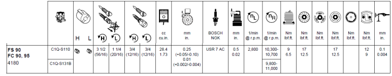

IAdjusting jets no help it runs starts but wont take throttle. Valve lash looks good. Right now im running bare carb covers and air cleaner missing. Opened carb all looks cleangood. Too things i noticed. Carb is spitting and when idling its rough like rich but every so often it smooths out for a second only. No idea what the bottom diaphram thing does one carb with big hose to motor? Also dont know jet settings. And whats that doohickey on top of gas tank under carb?

First you should not be able to adjust much with the limiter caps in place. How is the metering diaphragm? Is it stiff?
Also have you adjusted the valves? And have you checked the spark arrester?
