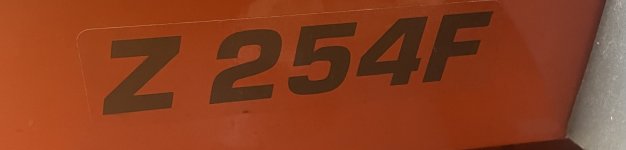

What kind of mower is it on. Model and serial no. Engine model and code. Sounds like it is flooding. Could you have over filled the tank and it is pulling fuel through the vent system. Have seen this happen.
Thanks for the response. I have experienced this problem at different gas tank fill levels. Attached is what I have. Any help would be appreciated.

Does not show the engine code no or the model no of the mower.
