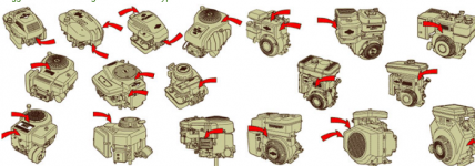

get the engine model, type and code numbers. Should be on the OHV valve cover
Is it located here?
I guess I don't really need the engine model number, I need the carb model number.
#17
the carburetor is part of the engine assembly, you need the engine model which is in the picture you posted.
a wire brush or find sand paper/scotch brite will take care of that rust to make it easier to read.
