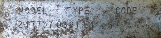

Thanks for the effort!
I think the type says:
217707 0391 B1 050120ZA
excellent
I am independent so can not do a cross check against that number but some here can,
so a 2005 engine ties in with it being a 2006 mower.
