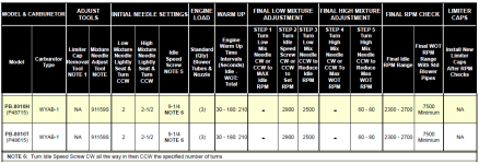

Well you need to post which one you have.
But if it has the wire spring at the end of the high tension lead then lead should be clip off a little and wire spring install in a new location making sure you hit the center conductor. Also you need to re-tune the carb after you install repair kit. Don't re-use old gaskets and diaphragms.
