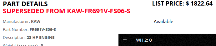

So you think the $4000 for a whole mower is just the cost of the engine. There is a lot more to the cost then just an engine involved. Below is my distributor FR691V list price on just one version of the FR691V.
So over half of the $4000 is the rest of the mower. Just wait until you find out what it costs for just one hydrostatic transaxles. They are around $800 list each. Then you throw in the deck housing at around $600 (spindles and other part are extra) and the seat at around $425. And don't even get you complete assembled mower. So the overall price of the mower is a considerable good deal. It is because the OEM gets a huge discount for volume of purchases that they can sell the complete mower for $4000 and make any money on it.
