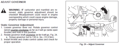

My hubby doesn’t know which hole to put the choke and throttle in the new carb. Briggs and Stratton d140 carb replacement

This why we recommend using a camera during disassembly. Most of us have cell phones with cameras.
