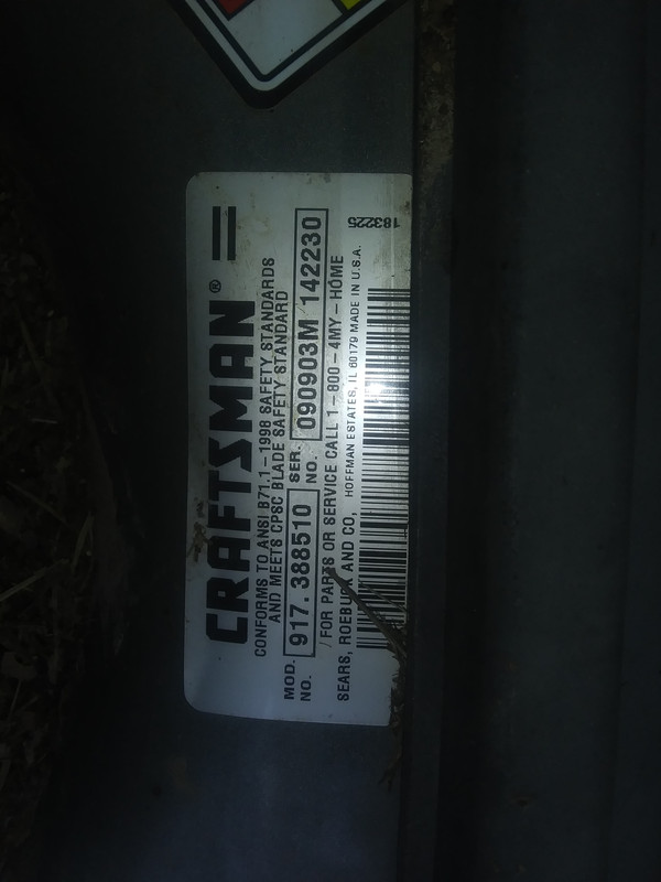

could someone confirm the length of the cable and conduit for me? cable on it appears too long. I'm getting differing lengths from an OEM husqvarna on amazon, and chinese knock off, as well as the Stens length.
Chinese one says, Conduit length : 45.35-inch , Cable length : 52.04-inch ;
Stens shows
59-1/2" Cable Length, 52" Conduit Length
Rotary, and the chinese one match up closely on the description and my measurements.
  • ROTARY: CONDUIT LENGTH: 43-3/8"
  • LENGTH: 52-1/2"
Measuring on the mower it appears the chinese one seems appropriate....
