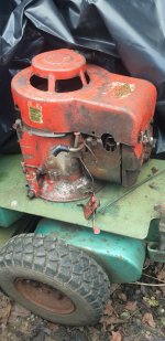

Hello
I have an old hayter 21 rough cut with the orange briggs and stratton engine .
I need a replacement coil but am having no luck as I cant find a part number for it.
Can anyone help me out
Thanks

You will want the newer style coil with the electronic chip added, as it did away with the points. What are the model numbers of your engine?

I cant find any

Model, type and code numbers should be stamped in the shroud, just above the spark plug.

Didn't realise for dirt and rust

397358 new style magnetron ignition module.
