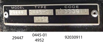

Engine data.

What IL is needing is the model and type number off the engine's rocker (valve) cover.

Is this what’s needed?

Looks like a Briggs Vanguard. Being a 92 I would be checking the breather assembly which should be located in the V between the cylinders mounted to the block under the air cleaner backing plate. I have seen more than one of the fiber disc fail or in a couple of cases disappear from the breather entirely
Could be something like a head gasket leaking also but the breather is a lower hanging fruit than pulling all the sheet metal to remove the head. Or in your case could require removing the engine from the mower to be able to get the blower housing off and remove the intake bolts to remove the head.
