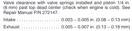

I greased the bottom of the choke shaft.
The valves were adjusted at .004".
Checked again and the cap at the rocker arm was off.
Those two bolts were tight.
