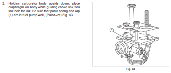

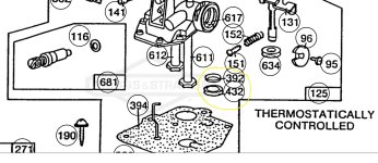

This is a 1990 model Troybilt sickle mower. It has been worked on by some very unskilled mechanics. I need to rebuild the carburetor linkage as it was all jury-rigged. I purchased a kit to rebuild it but the linkage was not included. One question I have is about the spring and the ring that it sits in. (Not sure the proper nomenclature of the part.) It is the spring that allows the gasket to function as the fuel pump. Does this spring and ring go on top of the gasket, or under it?

The spring and cap sits in a recess between the diaphragm and the carb body. the cap protects the diaphragm from the sharp edge of the spring so it side against the diaphragm.

  • / Carburetor problems on a Troybilt sickle mower from 1990.
Okay here is what you are needing info wise. This is from the service manual. The spring cap would next to the diaphragm so the spring don't the diaphragm.
thank you. this helped tremendously.
