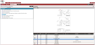

Hoping someone can point me in the right direction. I have a B&S model 12J802-2369-B1 engine. Need a carb and the B&S site part look up has the part number as 194146. I can't find this anywhere to purchase. Is there an alternative I can use because it's not available on eBay or Amazon. Or do I need to look somewhere else?

194146 is not a B&S part number.
Correct part number for you MTT is 694146

Thanks. Sorry I typed it in wrong in the question. 694146 is the part I cannot find anywhere.

Briggs dealer site shows it as NLA. No longer available.

The OP might try the following choke carb and remove the choke vane. It should still have the primer function path. Might have to swap the fuel bowl retainer as it is the main jet.
