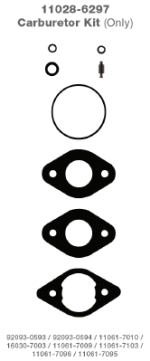

11028-6297 superseded to 11028-6316. But this kit don't contain every gasket depending on the spec number so you need to double check the PNs before ordering so you can order the others as needed. OR maybe I don't have all the supersedes loaded. Distributor files are screwy this year.
This is the PNs in the kit.
